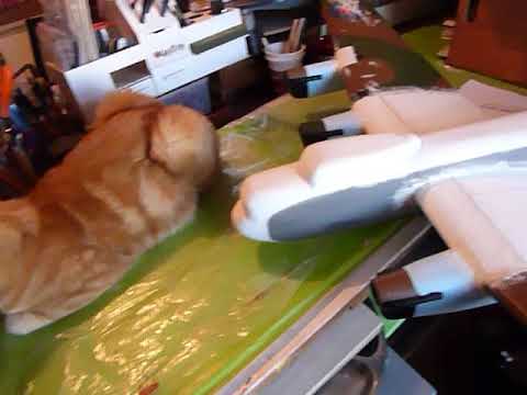

                  The inboard engine nacelles have been carved and sanded.

                      Outboard engine nacelles made up and all engines fitted .
                      Cut,carve,fettle,adjust,fit,fettle and keep repeating until happy !
