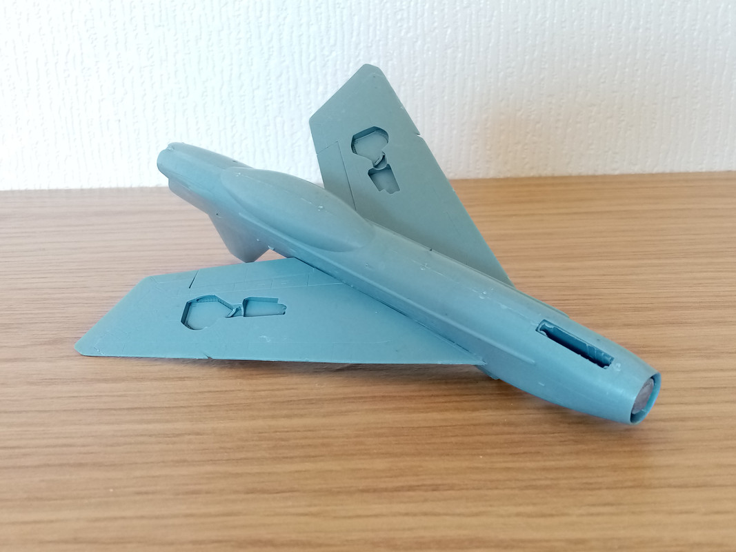

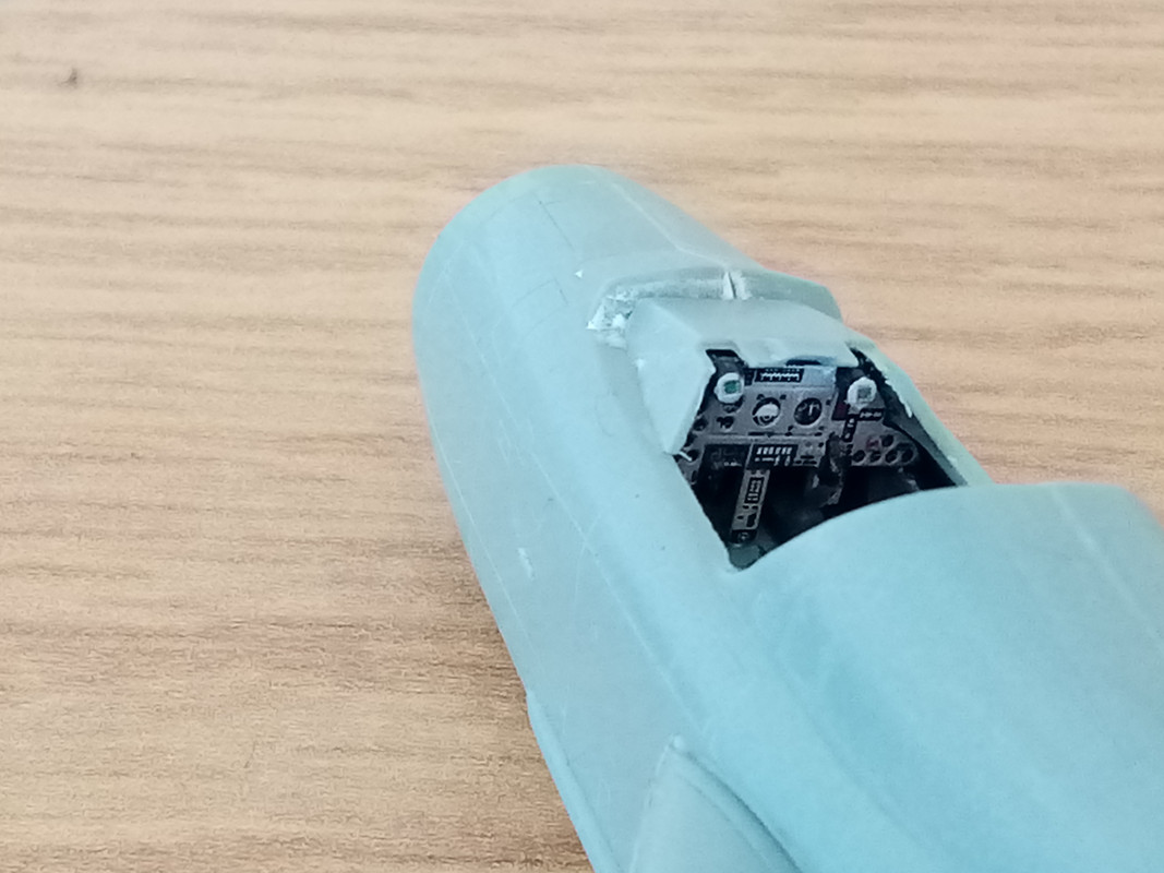

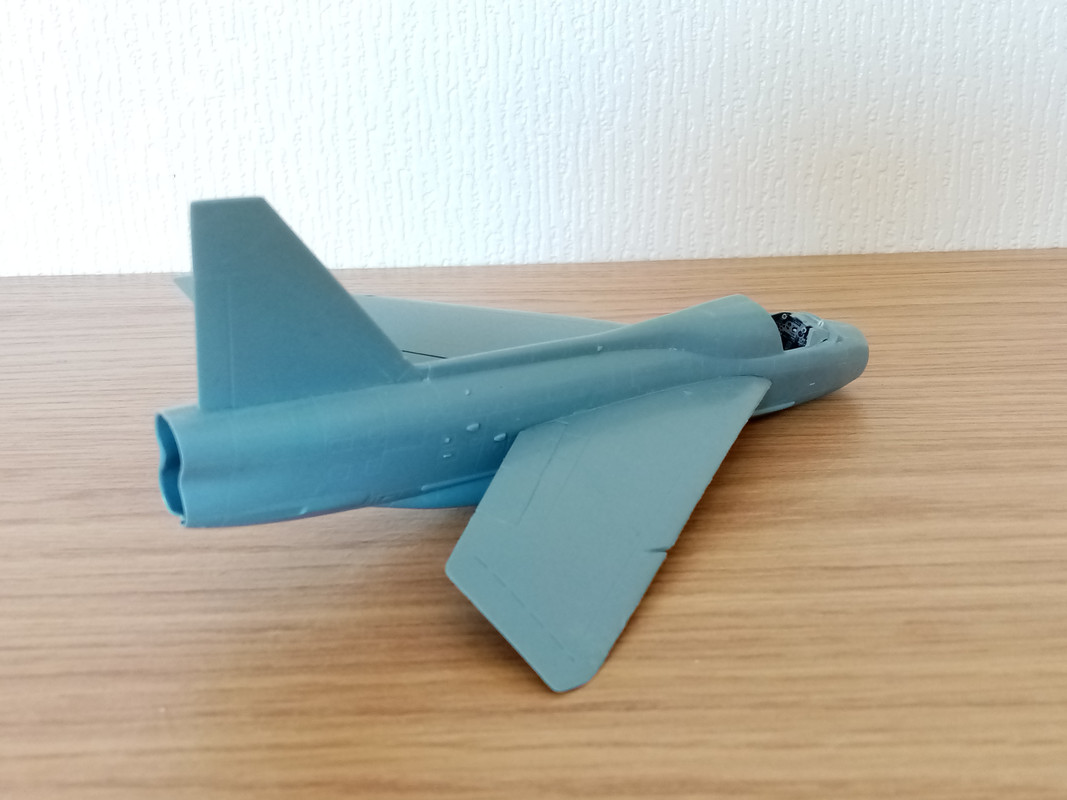

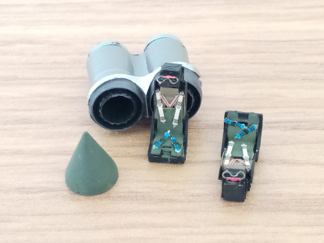

        Been a few weeks since I visited here for an update, real life has been getting in the way but, photo etch, I'm not really familiar with it so it's been a steep learning curve, it is so so mega hyper totally completely the fiddliest thing in the history of the universe! No doubt it's super clever and adds hugely to the detail of the build and for those who enjoy such things it's brilliant!! For me, not a fan! there's a lot more on the fret to add but I don't think I'll bother.
        As Sword kits are short run injection molded, this is evident in this kit, every part needs attention and dry fitting is a must, some flash, molding anomalies with questionable mold gate design choices and some really quite impressive ejector pin stubs! alignment needs to carefully considered, I'm not sure I got the fuselage halves just right, only a millimeter out but then other parts don't fit right like the cockpit canopy and the jet pipes for example. But, it is what it is and presents a challenge to my modelling skills which for me, is a good thing, others may complain, not me, it's the best Lightning kit I've known including the newer Airfix kits.
        After extensive dry fitting and fiddling about with no11 blade and a needle file it's mostly gap free, needs a coat of primer to highlight any further work needed

                    Nice work Miko. Did you add any nose weight. Most Lightnings do require it.

                      They certainly do, I crammed as much lead in the nose cone radar thingy and behind the cockpit too, should be enough I think
