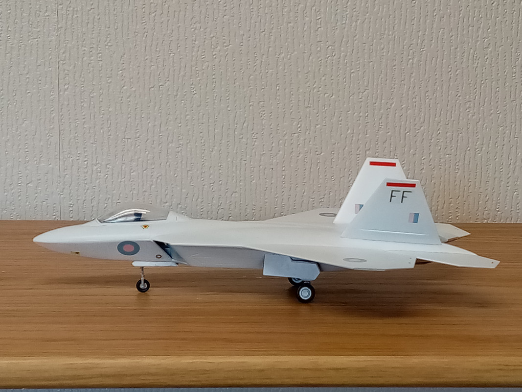

                      Scenario one of three complete!!
                      Miko (please check completed aircraft section for gallery)
