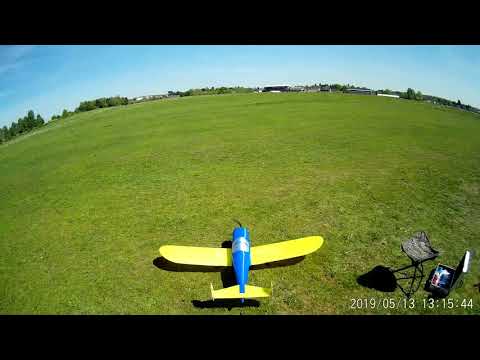

    Three flights today,then a spectacular crash !
    • Steven000
      • Aug 2018
      • 2826
      • Steven
      • Belgium
      Hi Barry, seemed to fly well but sad to see it crashing like that...
      Did you get a glitch on the elevator-channel or was it some sort of control error?
      cheers Steven

          No Colin the innerds are very complex almost woven type structure,a honeycomb mass of membranes,I am not impressed with the material for flying models it has no give in it like foam or wood,it shatters like glass,literally the ground was blue tiny particles,itt urns out the battery was ejected at some stage as it slid rearwards altering the centre of gravity it all happened so quickly.
          Yes parts are printed as small sections for example the wings are done in panels glued together at the edges,whoever designs these are very clever,perhaps in time they will improve.

            No glitch just literally broke up as it bounced at the end of the take off run,the canopy flew off filling the fuselage with air and the battery detached ejecting itself some distance from the crash site,the canopy was held in place with a strong latch so the fuselage must have literally bent when it touched,a very bizarre crash Steven.
