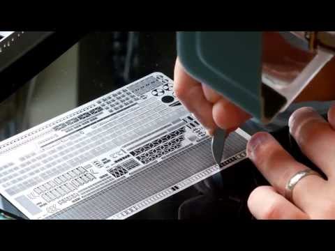

                        Love this picture:
                        Found this comment on a Youtube review of the glue:
                        Thank you for your great review of my glue. I shut down production for 3 months last year because of my son's health but I started back up and haven't looked back. One thing of note, my glue is not a PVA glue but a proprietary blend that I mix in my kitchen sink.
