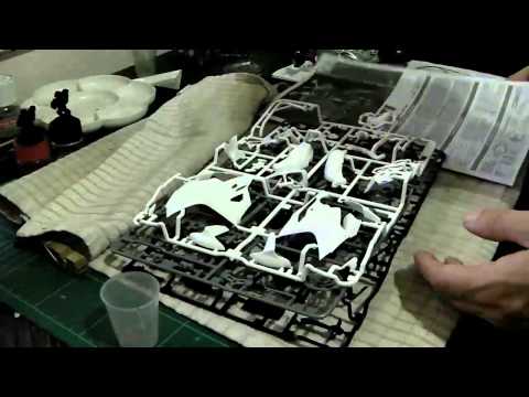

    The kit was received the other day and inspected and is well up to Tamiya's high quality standards with stunning detail, no flash, only a couple of minor sink marks on one of the sprues but in places that are hidden once built.
    The only dissapointment, (which I suspect is due to legal problems), are the tyres, they are exceptionally realistic in design and tread pattern, faithful to the Pirelli diablo supercorsa SP tyres, (the roadgoing version of the tyre used in bristish superstock racing for those who like to know these things), but they don't carry any sidewall lettering, only the direction of rotation arrows, typically as well as accurate tread, tamiya bike tyres in the kits will be accurately lettered.
    There are three large sprues, mainly bodywork, (white), mainly engine, (grey), and mainly Chassis, inasmuch as there is one (black). One clear sprue for the lighting and screen, a seperate top fairing in a small bag and of course the bag with tyre, vinyl tubing and fastening parts.
    Also the decal sheet and instructions which are thorough and clear as always.
    I've done an overview video and unboxing and having cleaned the sprues and dried them, started assembling some components,

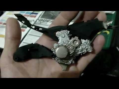

    petrol tank, front mudguard, paddock stand, engine, swingarm, airbox, exhaust, the next step will be priming, many of the parts will remain on the sprue for priming which is how I normally approach bike builds, the only difference so far is that I haven't assembled a frame as there is none.
    Below are some box and sprue shots and the video of the review / unboxing.

                        There has been a further working on the panigale, Engine is painted and assembled, I have Nato black on the cast aluminium parts, airbox, swingarm, subframe and satin black on a good few other parts, (callouts are matt and semi gloss but ref pics show the aluminium parts to be a greyer black than a straight matt black hence the above)
                        I have bits masked for the gloss black in readiness for the alclad chrome and stainless steel to go on, exhaust, fork sliders, headlight.
                        No pics of them just yet, i'll try to update as soon as i'm able but there will be a pause soon as i'm taking a couple of weeks break with my son.
                        Thanks for hanging in so far, I will endevour to get the photos on here, videos 1 and 2 on youtube are here if you have the patience to listen to me waffling a lot,
