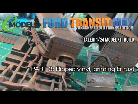

    One of number of weathering videos from humbrol Graham that maybe of use to you ?
      This might help Graham

          Graham, for rusty holes (insert own joke here ) have a look at this vid (it's toward the end), it may help.
