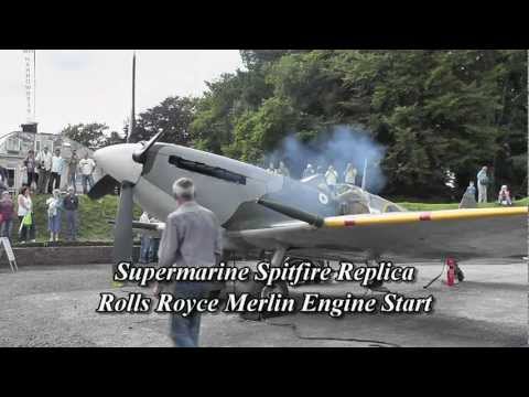

                  Down at Yeleverton just on the west edge of Dartmoor there is the remains of the airfield from WW11. RAF Harrowbeer.
                  Mostly grass with signs where the hard runway area. Interesting point is though that the pens where tha aircraft were parked are still there as a reminder.
                  Put Yeleverton airfield in the browser and lots of pictures come up. This one with a replica Spitfire shows the pens as they were.
                  Down that way worth a visit nice for picnics and a nice village.
