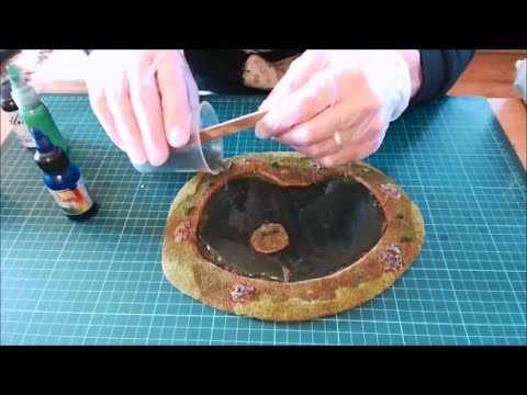

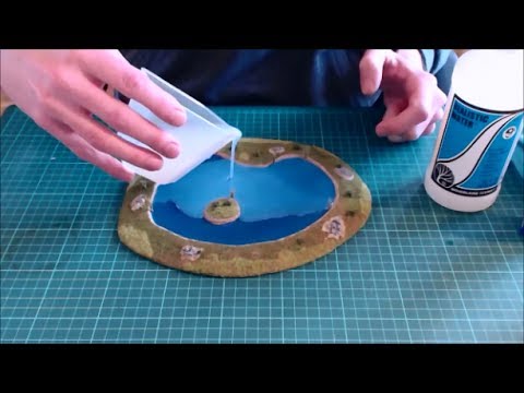

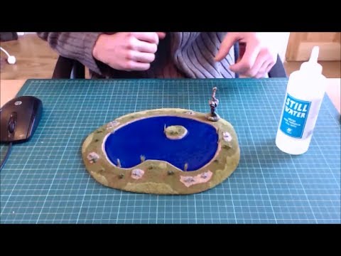

                        Alternatively, this guy has done some reviews on an assortment of the water effects stuff you can buy:
