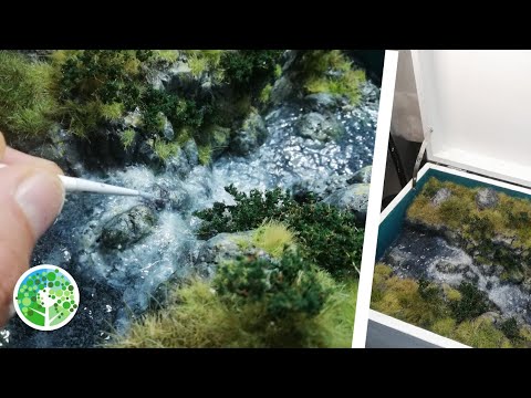

    Creating a waterfall
    Hi folks, I am attempting to create a waterfall effect using woodland scenics water effects. Now, I have tried spreading this white paste over acrylic perspex and glass; thinning it out to create a water effect. In a video I watched by Luke Towan, the guy just peeled it off after it was dry, but for the life of me, I can't. It's stuck fast and I can't get it off. It just chips off. Has anyone had a similar problem? Thanks

                  Stephen, hi , I've just looked at the video by Luke Towan .
                  From what I could see it was a layer of Mod Podge glue that he peeled off. Removing a coat of Woodland scenics would be problematic. Maybe email them and ask their opinion.
