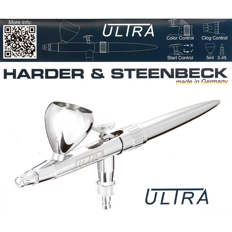

              There are good beginners airbrushes produced by major brands. Harder & Steinbeck have the Ultra which is designed specifically for beginners and the new 2024 Ultra is very refined hey one with a .28 needle and it will do a good job for you and help you learn airbrushing.
              The other benefit of Harder & Steinbeck airbrushes is how easy they are to take apart for a deep clean.

              Here is the Ultra
              That combination will do you proud but the most important thing is practise and don’t expect instant results. There are lots of YouTube tutorials worth watching.

                H&S Ultra 2024 is what I use. Great for amateurs and pro's alike. One needle for priming to fine detail. Loads on YT singing its praises. I've not problems with it and I'm new to the hobby.
