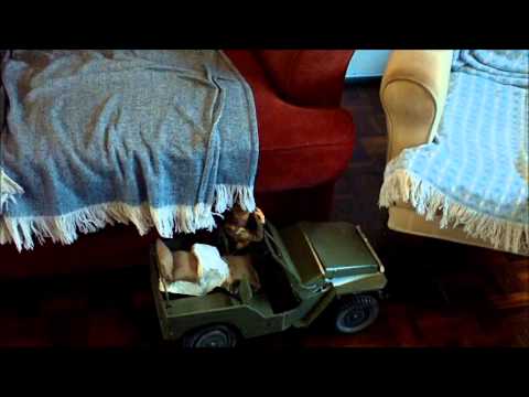

                  I didn't realise how tough my chassis is until I gave it a quick test drive.
                  (If the link works) Here is a video of the first time I tried the RC at home.
                  The music is coming from an MP3 player I have inside the dashboard.

                    Hehe, awesome work Bernard, poor Wilson indeed!
