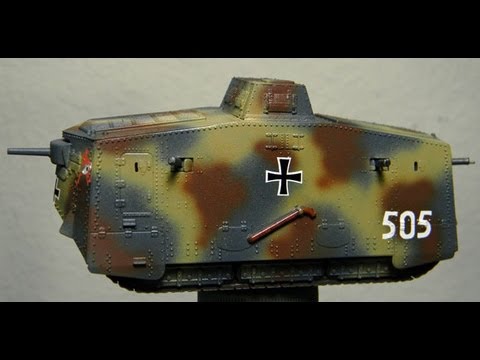

        A product such as Microsol, which is a decal softener is very helpful in making decals conform to irregular surfaces.
        See how it's made the decal bed down over the zimmerit on my Tiger
