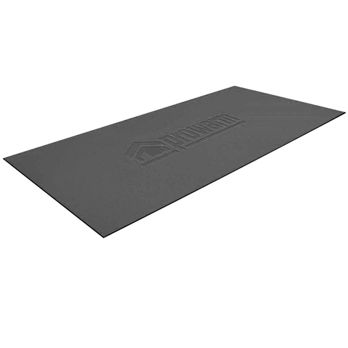

                    Here you go Tom:
                    ProWarm Insulation Board - XP-Pro available to buy online at The Underfloor Heating Store ✓ Next day delivery available on all orders ✓
                    You can get the XPS boards in a range of thicknesses, and when I bought mine (I got the more expensive blue one so I don't know what the budget stuff is like) they were prepared to supply mixed thicknesses instead of minimum quantities of a single size. I had to email them for a quote but they were excellent. They got back to me the same day with a very good price.

                      Great Stuff,
                      Thanks for that, if my next B&Q trip fails I will buy it from here
