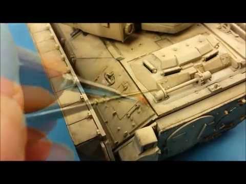

            I’ve not personally used the Vallejo washes but try watching the video, and have a practice on an old kit?
