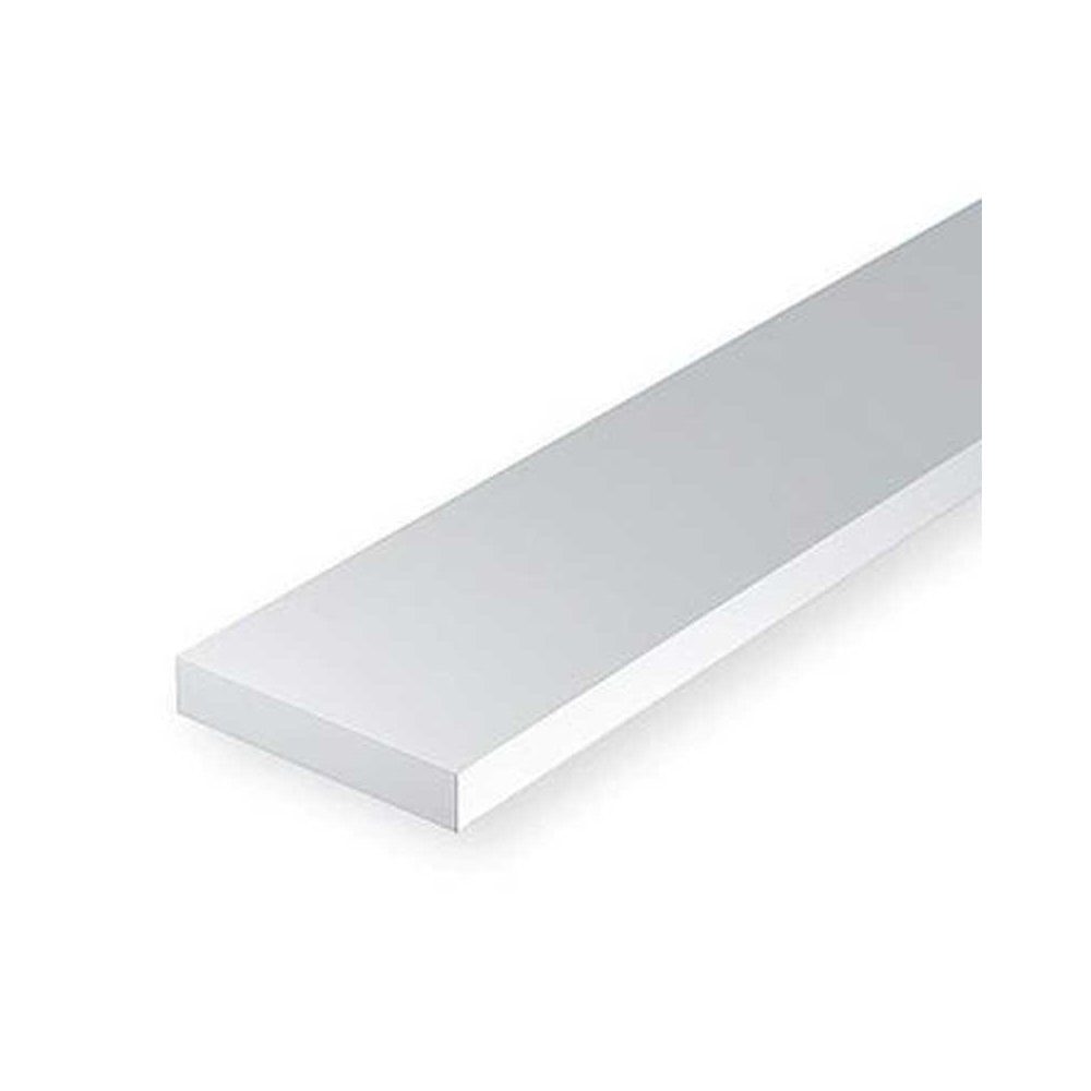

                      Cheers all, the good thing is the back of the cockpit glass is painted so no fear of fogging. When you refer to shimming what do you use, a slither of plastic spruce cut to fit?
                      • KarlW
                        • Jul 2020
                        • 1522
                        You can buy thin strips of plsticard which comes in useful, Evergreen Styrene in the site sponsors shop.
                        • minitnkr
                          Charter Rabble member
                          • 7510
                          • Dayton, OH USA
                          I use a dremel cutting wheel for plastic to remove inner sprue. This method puts no strain on the ring to be saved. Then use new #11 blade to finish. I'd prolly use thin shim or PVA at rear of canopy so as to preserve good fit elsewhere. PaulE
                          • Gern
                            • 9211
                            Here you go Carl:
                            10pk .25mm X .50mm X 35cm Plastic Strip EG100 Evergreen Scale Model Shop UK, 5* Customer Service, Fast Delivery, Reward points on every order
                            John does a range of sizes so you can measure the gap and pick the one you need. I'd fix a strip of this to the back of the clear part rather than to the aircraft body - that way you haven't got to worry about the corrugations. The guys have suggested the front of the glass but that seems more difficult as you have multiple curves to negotiate. At least at the back you're only dealing with curves in one direction.
                            If you fix just one straight side flush to the outside of the window frame with a small amount of extra thin and wait for it to dry - about 20 mins should be enough - you can bend the strip to match any curves and glue it in small sections. You need to be careful and hold it in place until the glue starts to harden - only a minute - then move on to the next bit. You can pre-bend the strip with your fingers to get it to the approximate shape you need before you start. Leave an overhang at each end so you don't have to worry about precisely matching the length. Once you're done, just cut them flush with the frame.
                            With a suitable bit of painting, the extra strip becomes part of the window frame.

                              Thanks for that link and explanation Dave, I was struggling to find it in the shop. I’ve ordered some so will give this a go. Sounds useful stuff to have in the kit anyway. Carl
