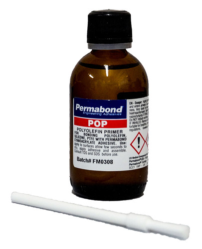

                        Bob how I do it. Produced this some time ago. I use the very thin on average & wick around the outside of the PE. Goes off very quickly. The secret is to get some primer. prime the plastic before hand. Unfortunatley the primer shown here is only available in 50 lots.
                        See if i can find another primer they do exist.

                          Here are some primers after a quick search, Probably others.
                          TECHSiL® Cyanoacrylate Primer 77 is a single component primer for use in conjunction with TECHSiL® Cyanoacrylates. TECHSiL® 77 enables the adhesion of difficult to bond plastics such as polypropylene, polyethylene and silicone rubber by increasing the surface energy.

                            Some great tips there Laurie, like the look of the .
                              Yes that looks good as it is the cheapest. Pity about Power Drop. It has a felt tip which makes it perfect for our sort of work.
                              Best with a liquid, I think, to apply it with a small amount on a cotton bud as you only need as much as you would get from a felt tip.
