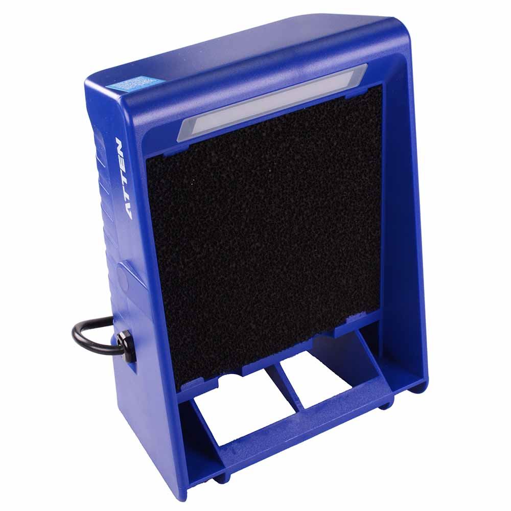

                  Plumbers power flow flux works well John, and is fairly odourless. Just needs to be washed off in a meths and water bath afterwards. You can also get soldering stations with fume extraction to protect you, should you want to try it…..
                  Something like this….
                  Desktop fume extractor suitable for mounting vertically or horizontally to remove soldering smoke quickly and safely. LED Lighting function Highly activated carbon material with strong absorb function Voltage: 220-240V UK plug
