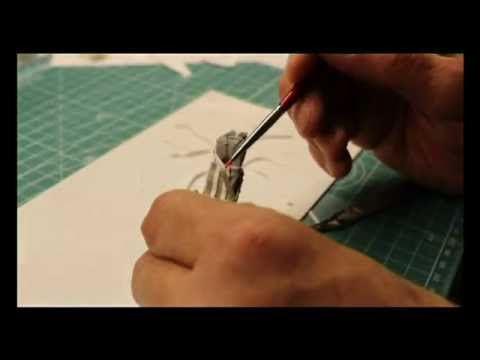

    This was an interesting technique using Milliput for the belts but no information on making the buckles
