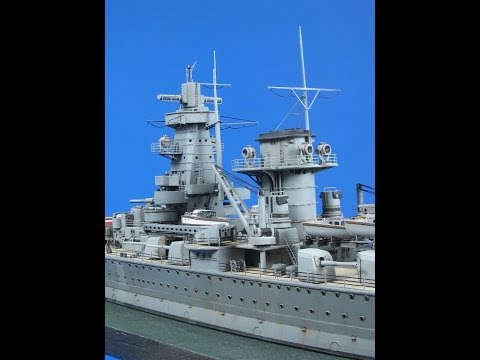

                Hi Shaun, welcome aboard. Found this out for you:
                There is a Part 2 as well.
