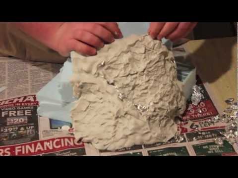

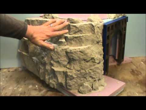

b) Pour and/or spoon wet plaster on to the support. Immediately press on to it a sheet of crumpled kitchen aluminium foil. Make the size of the crumples to suit the scale of your model, remembering that in 1/76 scale (OO gauge) ¼ inch represents 19 inches on a rock face. Brush a release agent (2 drops of washing-up liquid in a cup of water) on the foil and press that side onto the plaster, pressing more for more rounded features or less for less rounded. The first picture shows the first piece of foil being applied.
[ATTACH]150179[/ATTACH]
c) The second picture shows the finished surface: it has smaller and sharper irregularities than in the first picture.
d) After the plaster has set the foil should be picked off bit-by-bit. Tweezers are useful here. The surface can then be painted as shown in items 1 and 6.

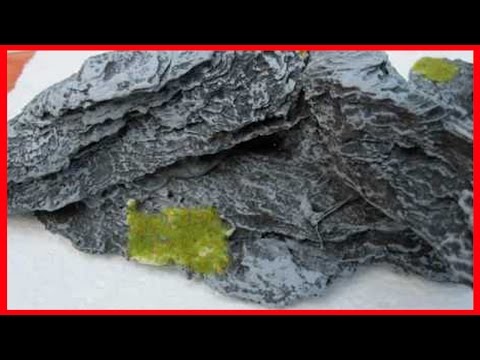

a) This method was taken from the Internet. Polyurethane foam has the advantage of being very light. Several layers of slabs are placed one on the other to the required height and glued together. PVA can be used. Two fingers are then used to pluck off bits of foam to make an irregular surface which is quite realistic. You can choose to preserve the horizontal lines as strata (but without the horizontal flat surfaces shown here which are not very geologically correct), or by plucking across the lines to make a single massive face.
[ATTACH]150180[/ATTACH]
b) The surface can then be painted either in subtle variations or, in the case of the single massive face, a more uniform colour.

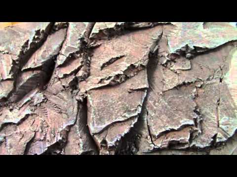

Use a wide-bladed craft knife to cut, then use a stiff wire brush to roughen the surface and edges. Quite a lot of artistic skill is needed to trick the eye that the surface is a hard rock. Dry brushing gives it depth, as seen above:

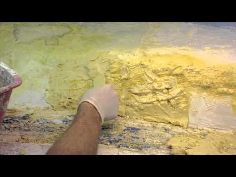

You could hand-carve a rock face from plaster. This method uses one or more tools with ends which have a pick or a flat scraper etc. Polyfilla is rather hard for this and a better alternative would be Woodland Scenics Carving Plaster as described in Items 1 and 6. The tools are used to break off bits of plaster leaving hard edges, lumps and cavities. It requires some artistic skill to make the result looking natural.
