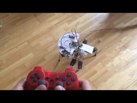

    This is almost complete frame (except "arms"/weapons) and close to complete electronics:
    Motion is controlled by RaspberryPi. Programming in C++, from scratch. It is controlled with PS3 joystick, but there are plan to have some autonomous functionality.

            A little bit from inside the "brain" of the robot:
            The robot has full model of itself (in order to do correct simulation) and it's calculating where to make steps in such way that legs do not collide.

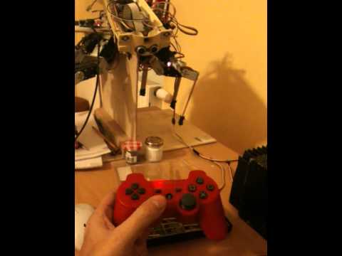

                      A short video from testing of arms:
