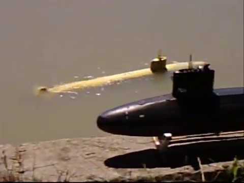

                          I test ran her at the lake today with some other boats in our group. Mum drove the BB and had fun. The LA went for an hour on a charge and the Blueback 50 minutes. Not bad I reckon.
                          Here’s a video link for 5 minutes I took today
                          The LA will need bigger front dive planes to dive dynamically. I’ll use those ones on my next one with the D&M WTC from the raffle. She was fun to run on the surface for an hour though. I had a sail of one of my yachts for a while at was bored shi…s!
