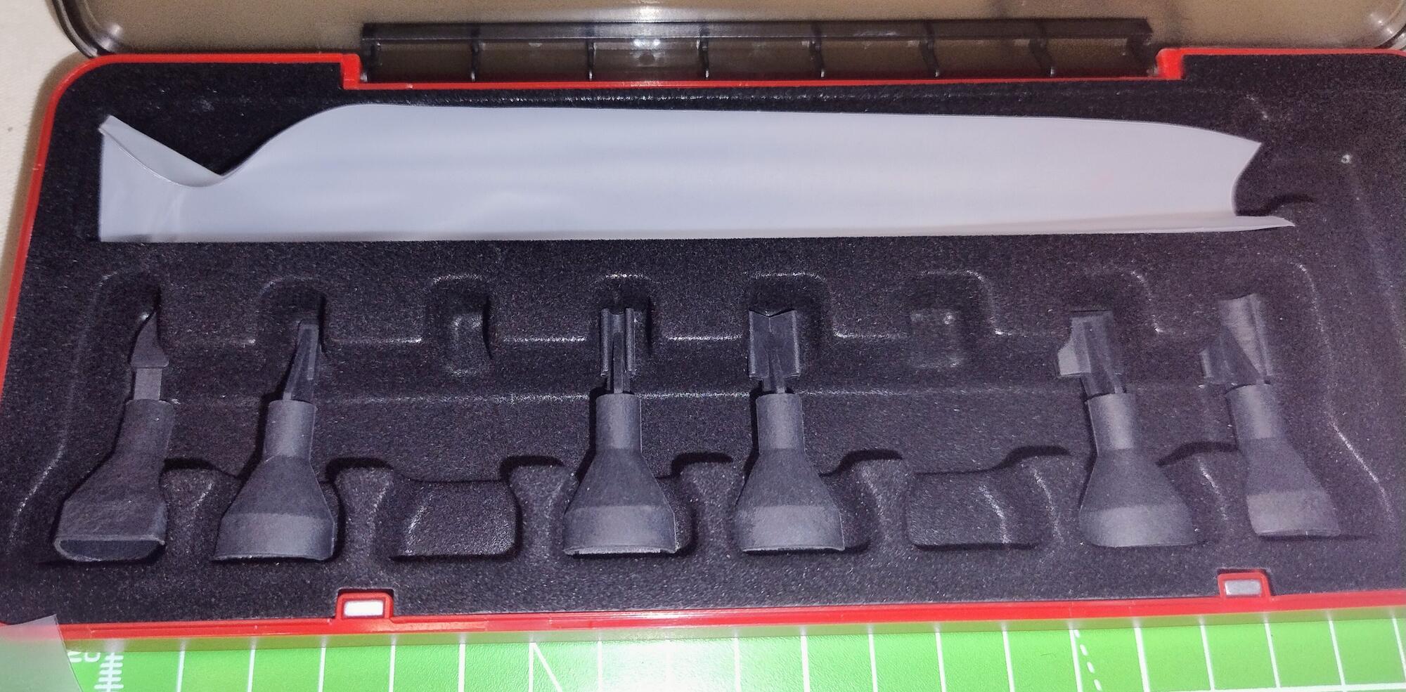

    It comes in a lovely hard plastic case with flip up lid.
    Click image for larger version  Name:	Dspiae sander10dec24 (1).jpg Views:	0 Size:	385.2 KB ID:	1243060
    The sander has interchangeable heads (x8), some are small, some are larger, some are pointed, some are rounded, so you get a good selection.

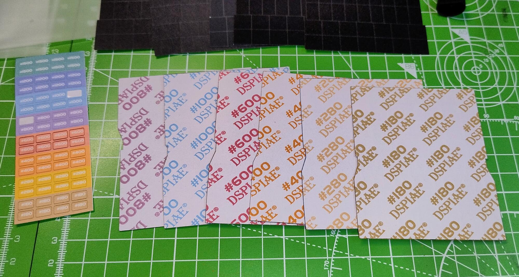

    It also comes with two sets of sanding papers, which I thought was very good. Each set has one sheet of each grit (180,280,400, 600, 800, 1000) and each sheet has about a 12-16 of the smaller sanding pads, for each shape sanding head, all pre cut and with adhesive backing. So you literally have a fair few hundred pads to start with!

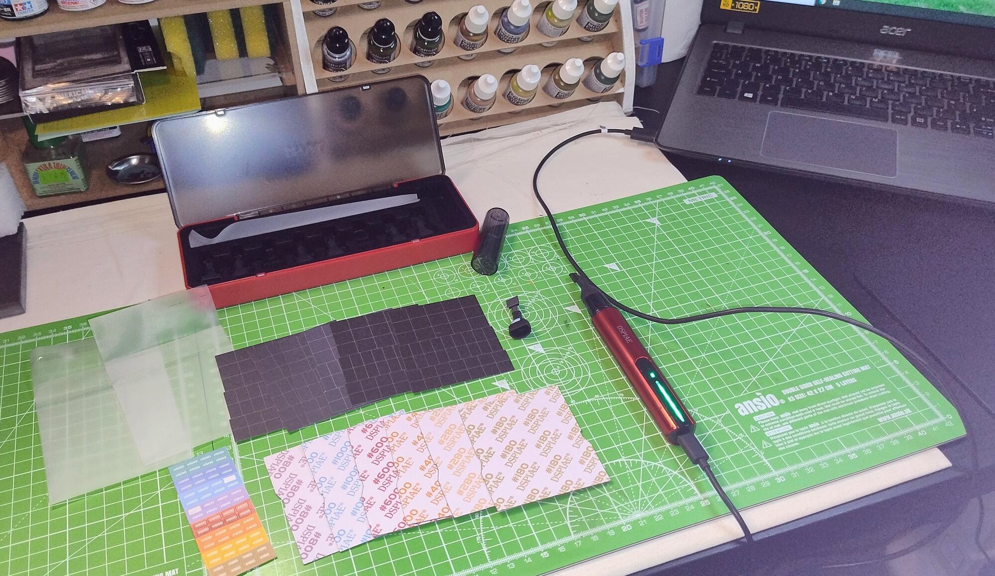

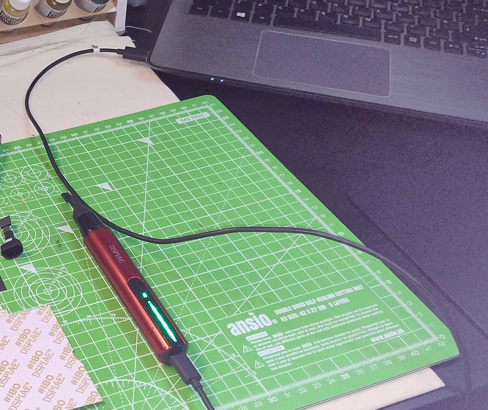

    It is powered by a built in Li-Ion battery, charged via any usb connection, eg: mains, laptop, power-bank, etc. I have a laptop near my model space, so I will use that to charge the sander, although it came pre charged and has not yet run out of power yet.
    When its charging the sander has a large green light that illuminates, not sure if this will be red when its low or needs charging?
    Also note that the sander does not operate whilst its being charged, so you have to disconnect the usb lead for it to work.
    Click image for larger version  Name:	Dspiae sander10dec24.jpg Views:	0 Size:	588.5 KB ID:	1243064
    It has three speeds, selected by the power button on the sander. It also appears to have a sensor on it, so if you press too hard, it slows down and then stops, until you release the pressure, again a bit like most modern electric toothbrushes.

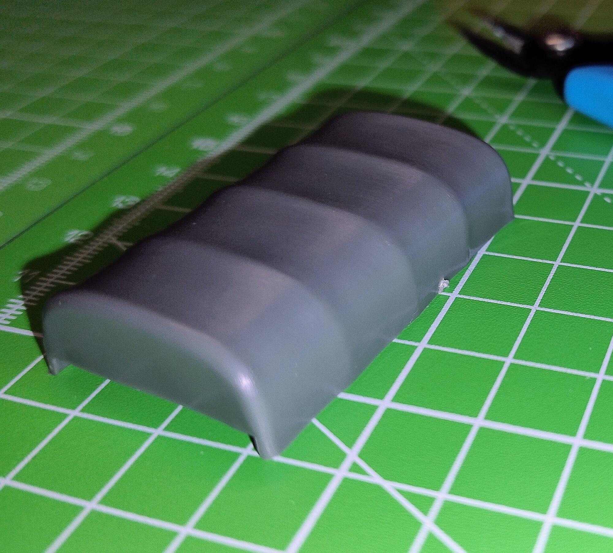

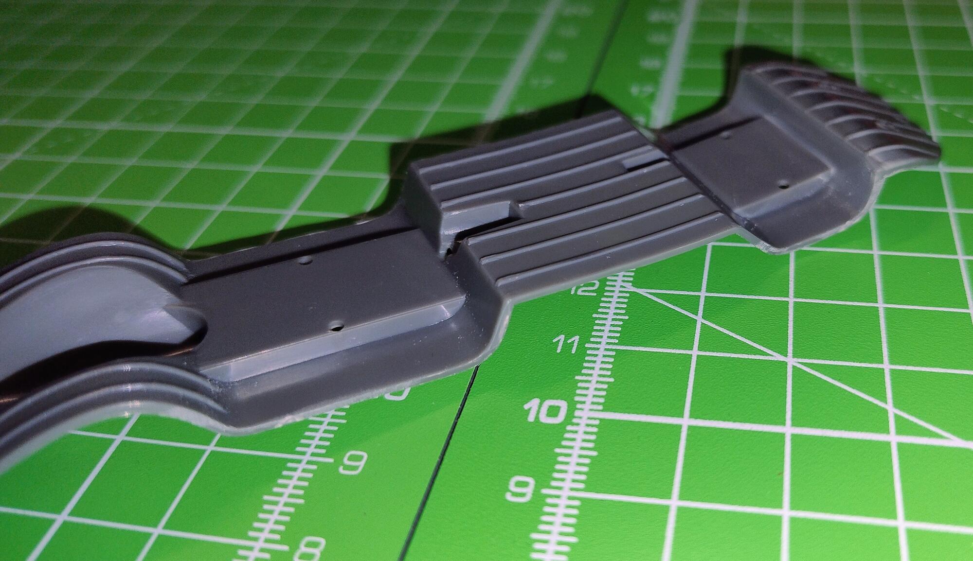

    This chassis has a small dimple that needs smoothing down. Here's before (sorry, rubbish photo!)
    Click image for larger version  Name:	Dspiae sander10dec24 (8).jpg Views:	0 Size:	310.1 KB ID:	1243067

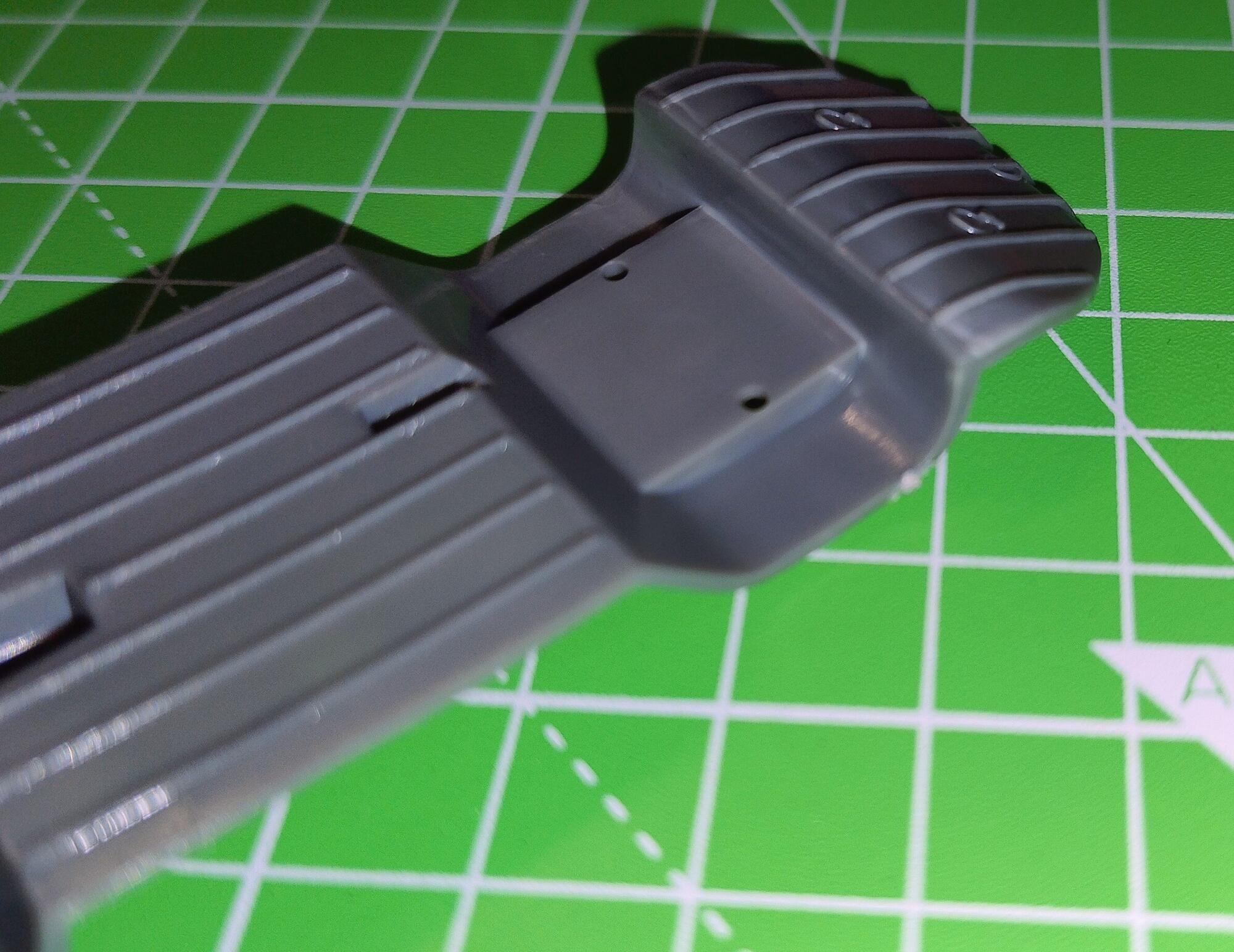

    And here's after using the sander, NB, it still looks a bit rough in the photo, but to the touch its really quite smooth.
    Click image for larger version  Name:	Dspiae sander10dec24 (9).jpg Views:	0 Size:	263.9 KB ID:	1243068

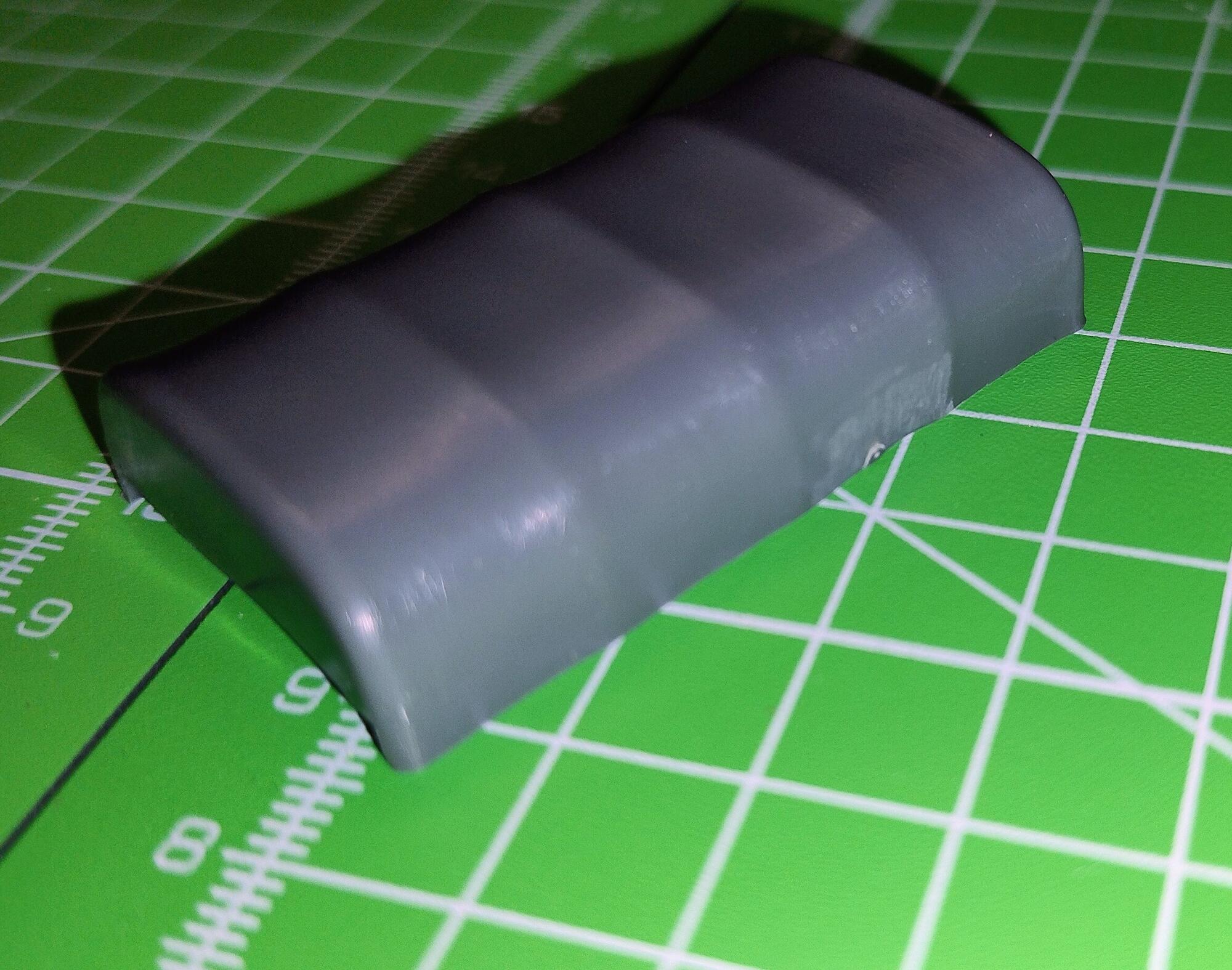

    And here's another example, the top canopy and another dimple that needs sanding....Before...
    Click image for larger version  Name:	Dspiae sander10dec24 (10).jpg Views:	0 Size:	422.9 KB ID:	1243065
    And again, here's after using the sander, and adgin it looks rough in the photo, but is actually smooth to the touch.

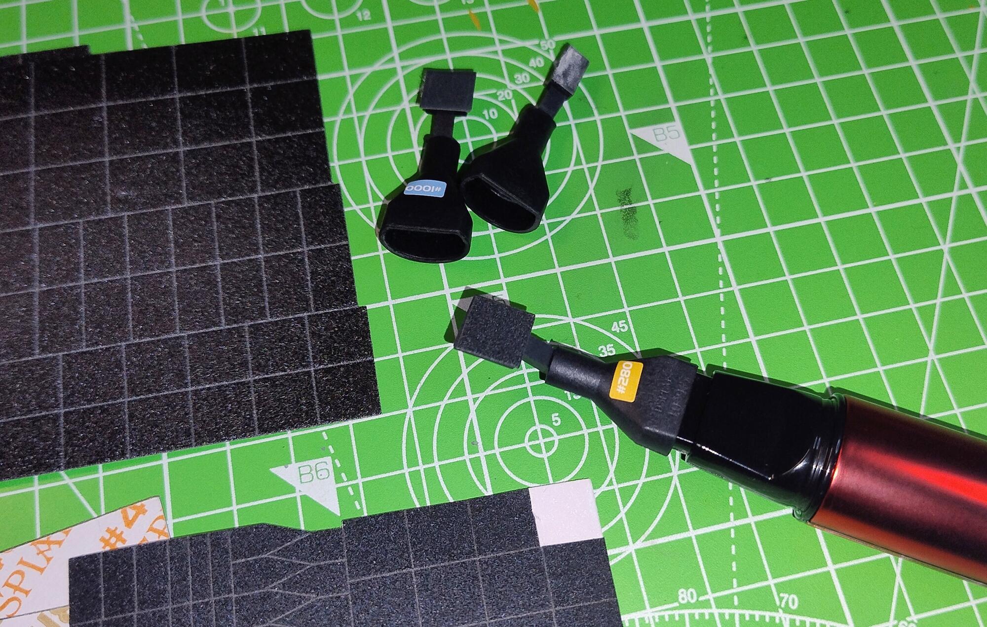

    NB: in both the above this was initially using 280 grit, then 800 grit then finishing with 1000 grit, and both took about a minute each time, switching the heads literally takes about 3 seconds!

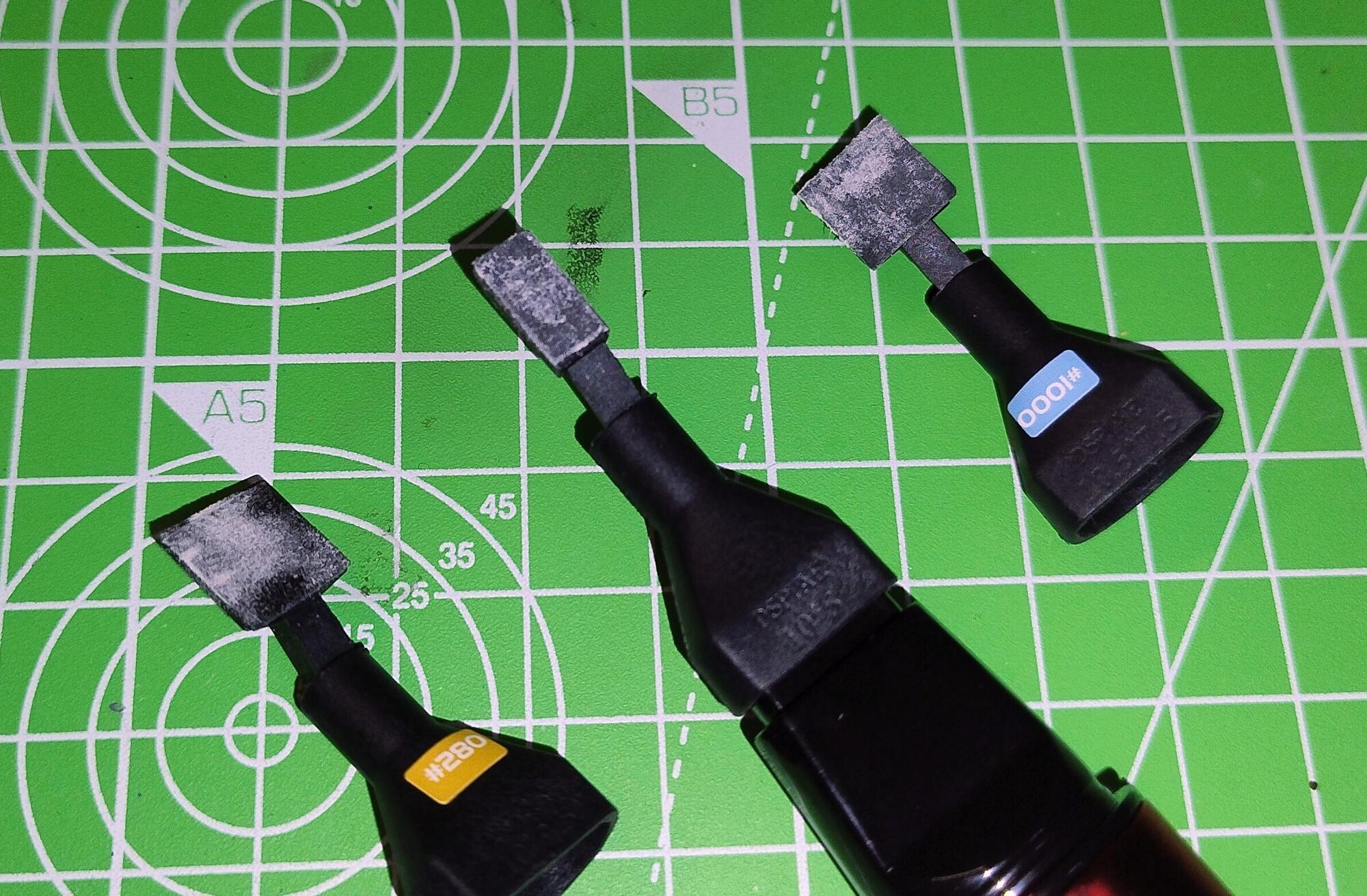

    Click image for larger version  Name:	Dspiae sander10dec24 (11).jpg Views:	0 Size:	337.2 KB ID:	1243066
    These were the heads after a few minutes playing around sanding both the bits above, plus a few bits of sprue, etc, so they are clearly worn, but still have more use left in them, so they look like they will last a while before needing changing.
