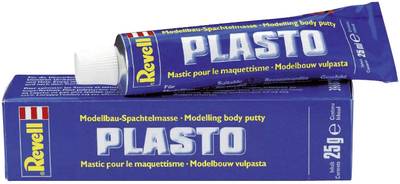

        I used to use Revell Plasto:
        and was quite happy with it, though it really needs a bit of kneading before use, else you’ll first get glue-type stuff from the tube rather than filler for quite a while. By squirting out the gluey stuff first, the putty is much more usable — especially once so much of the glue has gone that the putty is mostly dry when it comes out of the tube.
        Since the last local model shop closed, though, I’ve been using car body filler from a tube instead, and that works fine too.
