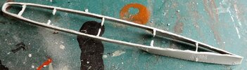

    From the stash, I retrieved the Dragon 1/700 USS Buchanan - this has a one piece hull. Normally I would add the deck to stiffen things up, but I wanted to see how I went without.
ID:	1186301 Masking tape added along the waterline as a guide. I used 15000 rpm at first, but I could also use 10000 rpm. When using this type of saw you should wear eye protection, as bits fly everywhere. It took about 4-5 minutes to cut the hull - the tool got hand warm, but nothing worse.
    This was worst possible case, a small flexible model & first time using this thing. It felt good in the hand, nothing rattles when you shake it. No sharp edges ,there are fixing screws open to view ( and check for tightness ). It vibrates when using the saw, but you'd expect that from a light tool at quite a high speed. With sanding drums & engraving bits not a lot of vibration. Click image for larger version

    Initially a bit wobbly, but as I got used to it, and improved - if I had added the deck it would have been easier!
