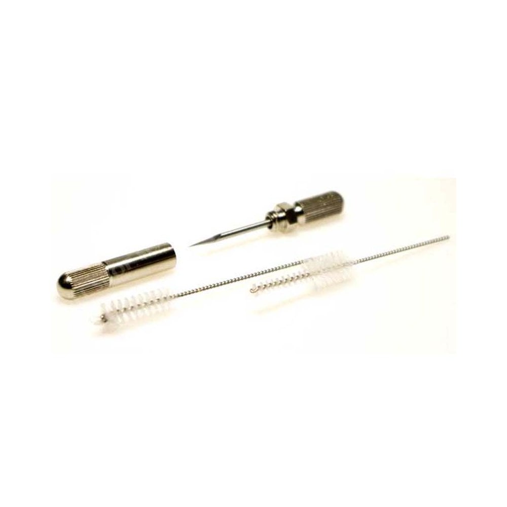

    Personally I use IPA to clean, it tends to eat through whatever I've been spraying. and interdental brushes for the nozzle. I also use a nozzle reamer as a final check/clean, although there is rarely anything left after the IPA has been to work.
    Nozzle Cleaning Set HS117400 Harder & Steenbeck Scale Model Shop UK, 5* Customer Service, Fast Delivery, Reward points on every order

          Bob: I've got some IPA (I assume you mean Isopropyl Alcohol and not India Pale Ale!) which I'll try. I've also ordered that cleaning set from John.
