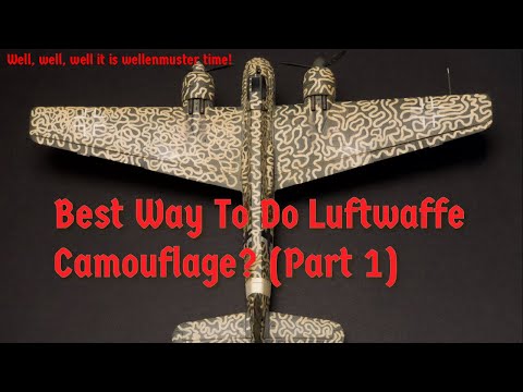

                    wow ... cool looking camo technique ... not sure i wud be brave enough to try that but found this on the net ... easy when someone else is doing it .....

                      Really like that idea Lindsey. Thanks for posting it.
                              That’s an interesting idea. Probably easier just to buy an acrylic paint in the right colour if one can be found . Might be something I have a dabble with.
