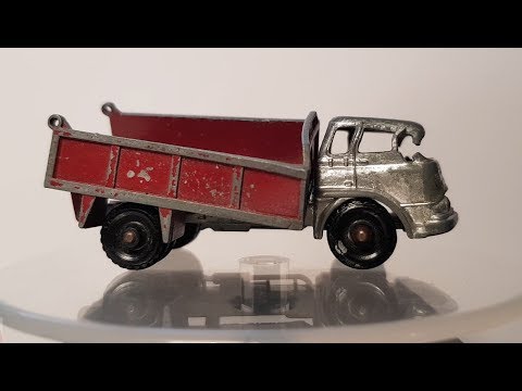

    Hi everyone my first post here and about to hopefully start into airbrushing with good equipment.
    I have a collection of 1950s Dinky vehicles that I would like to renovate and would like to know what paints are best suitable for this project.
    I was hoping that acrylics might be ok because of the easier cleanup for airbrushes etc, but advice needed please.
    I do not own a decent airbrush at present so that will be my next task along with compressor etc, although I have been playing about with a cheap Clarke’s airbrush given to me with air bottles, which was enjoyable.
    Thank you in advance for as much help as possible.

    Hi Ian,
    I don’t see a problem using acrylics for your project. I’d suggest getting yourself one or two acrylic colours,
    and an acrylic gloss varnish and have a practice, see if you get a finish you like.
    Vallejo model air are a popular range, but I’d recommend adding a Flow improver, both are available from the shop that runs this forum Scale model shop.co.uk (if your UK based)
    At least with these you can touch up with a brush relatively easily.
    There are lots of other brands available such as AMMO Mig, Ak interactive etc
    There is a guy on YouTube that repaints old die cast models, I’ll see if I can find him for you....might be useful?
    Hope this helps

      Hello Si thank you yes that is very helpful much appreciated, yes I am in the uk, Norfolk.
      It will now maybe allow me to pick a suitable airbrush for this type of finish if there is one more suited to Acrylics.
      I have heard of the Vallejo paints and seen a few people on YouTube using them for various works so was hoping someone might recommend them.
      I would be interested in the guys name that does the die cast models if you can hunt him up for me.
      I have looked at a few of the vids on YouTube of people restoring die cast vehicles but must say some of the paintwork when finished does not look brilliant, it may be the lack of preparation to the vehicle body’s because some still looked to have a little corrosion before painting.
      I have seen that one person had started to try to repair the corrosion by putting them in a bath of liquid of some sort with a nickel anode and low voltage current passed through them which definitely seemed to repair them.
      Do you have any advice regarding good airbrushes or shall I post on the correct forum.
      Thanks once again you have been very helpful.

        don't know if this will be much help?
        • Si Benson
          • 3572
          This guy uses acrylics...
