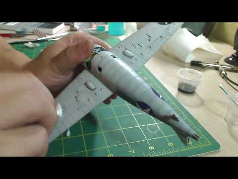

                  I have had success using a Pastel chalk/water/dishwashing soap wash. Here is a good video guide:
                  Also being water based, you wouldn't need to use a clear coat first. I would suggest using the second technique shown in the video. Good luck.
